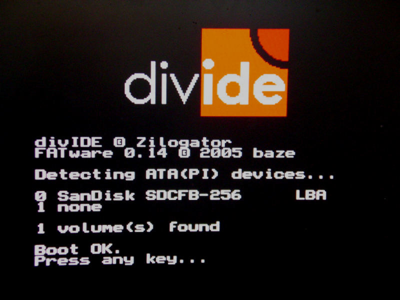

Source code of FATware system is now free.
BAZE (author of FATWARE) send me source code of last version FATWARE 0.14 :). Last official release is version 0.12 and all my next modifications is for this old version.
And what is new in FATWARE 0.14 ?
- 8kB code must be flashed to DIVIDE rom only
- after start ZX will fat boot BIN file from directory "FATware" on master device with FAT16(need master boot record)
- this fatware use 16kB of code (old version only 8kB)
- some TAP files work correct (old FATWARE 0.12 load incorrect data from TAP file with Prince of Persia...)
- I don't know about next new features :(
Bugs in new FATWARE 0.14:
- error chars for sign directory (directory sign as ":" )
- after last file in directory show bad chars (this is only cosmetic errors, browser work correct)
Source code is for ZILOG DEVELOPMENT STUDIO and manual for assembly is included in TXT file. :v2_dizzy_roll:
FULL SOURCE CODE: http://velesoft.speccy.cz/zx/divide/...01)-source.zip
ASSEMBLED FILES: http://velesoft.speccy.cz/zx/divide/...011-05-01).zip
http://velesoft.speccy.cz/other/photos/fatware014.JPG
Here is actual version with bugs in browser, for testing (without source code):
You must on master IDE device create directory "FATware" and copy bile "boot.bin" to this directory. Flash new FATWARE from TAP file and restart ZX...
