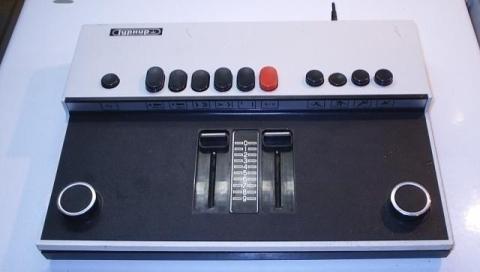

    I have an old russian video game, called "Turnir." (I attached a photo.) I bought it some weeks ago, but unfortunately it has some problem(s). I would like to repair it, but I have no information about this game. I've spent so many time searching and searching, but no success.
    I found this:
    http://msk.molotok.ru/item1351907661...gr_turnir.html
    But without Russian knowledge I can't register there and ask the seller to scan the documents and upload somewhere.
    Is there anybody here who could scan a circuit diagram and/or a user manual and upload somewhere, please? I would be very happy. Thank You very much in advance!

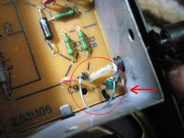

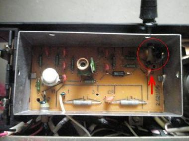

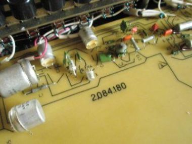

    The problem: no picture and no sound. There is only one sign of life: when I turn on the video game, the screen of the tv turns black.
    I attached some more photos. As You can see the IC is AY-3-8500-7.
    There is a part of the modulator, we don't understand. I marked it with a red circle on photo #3 and #4. On the photo #4 You can see it better, that the 2 cables are connected to each other and we don't know why? The more interesting is, that it seems to be original, because the soldered parts are marked with that green substance.

    You can use as basis for the most similar scheme to К145ИК17 (look here: http://byte01.narod.ru/ik17.htm)
    The main difference between IC К145ИК17 from AY-3-8500 is used in К145ИК17 entry to choose the game with one button (when you click on it the game are changing in sequence), and the AY-3-8500 - six separate outputs for connecting rotary switches, which turn and will select the game (or multibutton switch with a dependent fixation). On this basis we can conclude that one of the earliest Soviet consoles - "Турнир", which appeared in 1978, probably is not installed chip К145ИК17 and AY-3-8500, as the game it is chosen such that multibutton switch (with four instead of six positions, as fotopistolet in "Турнир" is missing).
    Table with the findings for the AY-3-8500 is here: http://en.wikipedia.org/wiki/AY-3-8500
    And the fact that there is a black background means that the modulator (box closed metals) works.
    Check the signals on the chip itself AY-3-8500, may not be running master oscillator. and if possible connect the console to the low-frequency input.

    If I think well, does it mean that I need an old tv? You know, I have another old console, a Conic TVG-101 (Made in 1977). That machine works, but I can't fix the screen on my tv. The screen jumps vertically very fast. So I decided to buy a contemporary tv (a Junoszty, or a hungarian made) to test these old games, because I'm not sure that today's televisions are suitable for it.
    Can I ask what is Your opinion about the fourth picture? Do You think it is normal that the two cables (in the red circle) are connected to each other?
    In the photo hard to see what was on the loop, but if it is short-circuiting, then clearly, this is not normal and the TV did not show, try to remove it.
    I hope you know that the prefix should be connected to TV antenna input and to scan the channels to find the channel where it should show?
    By the way, modern TVs do not have problems with attachments on К145ИК17.
