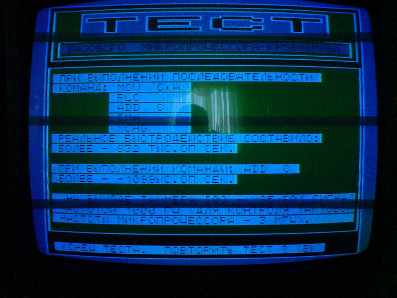

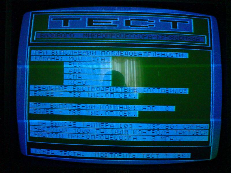

Old 9th February 2009, 10:43   #7
Member
Join Date: 14th October 2008
Location: Ставрополь
Posts: 69
Thanks: 1
Thanked 10 Times in 7 Posts
Vadik is on a distinguished road
Default
Тест быстродействия на 6Мгц и 3Мгц
ID:	10581   Click image for larger version
