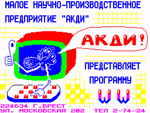

    I want convert piece of code from CP/M file of "Byte01" computer to working in clone ZX Spectrum "Byte" BASIC. Program WW.COM after run in CP/M OS print on screen image and play music. I found image in WW.COM code in offset 2404. Sound data is probably in offset 1FB5 - 2403. Need help to disassemble code. I want to get something like in attach video file (AKDI.zip)

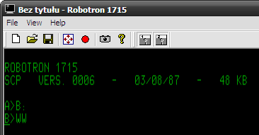

    Yes, right but i don't know how use this tool :-). Maybe anyone look at code?
    Program WW.COM from disk image cpm_games2.kdi after change extension .kdi to .cpm possible mount in EMU 1.01 Robotron 1715 to Drive B: and open Debug window:

    For me disassembling is difficult :-(. Screen image I found in a simple and fast way - opens WW.COM in HEX editor :-)
    Sound data is probably in offset 1FB5 - 2403 :-). This sound data is for play over chip VI53 in "Byte" or "Byte01" computer. This data have characteristic structure - every fourth position occurs 10 HEX.
