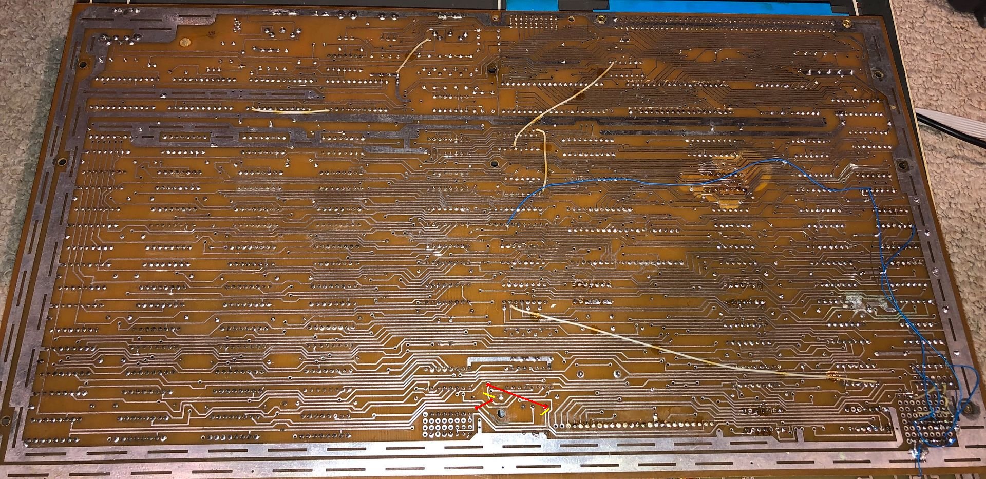

    Please look carefully at the tracks, from the underside, around the board mounting holes. They are often squashed and short-circuited.

    I did find a dead bug in the case but I removed it. There's some rust on a few chips, but other than that everything looks okay. I've been removing the chips and testing them, one by one. So far I've found three bad ones. I think I might just have to keep replacing chips until I find all the bad ones. The circuit board has "556-04-89-3" written on it.

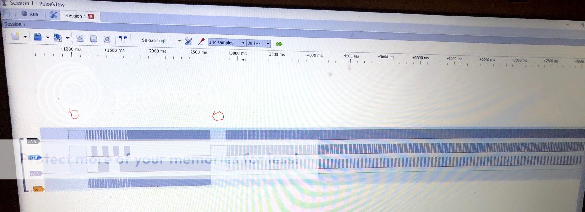

    This is what the composite sync looks like when I have a stable picture.
    Edit: Yes, I added a 220uf electrolytic capacitor across C33. I made every modification in that circuit diagram except for wiring the resistors directly to the inverter. When I did that I only get a solid white screen.

    When I boot the computer up, all 4 chip selects on the ROM are high. When I press the reset buttons, I see continuous data on the two inverted chip select inputs. Should they go high again after the boot ROM is copied to RAM?
