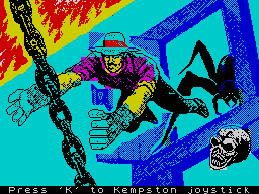

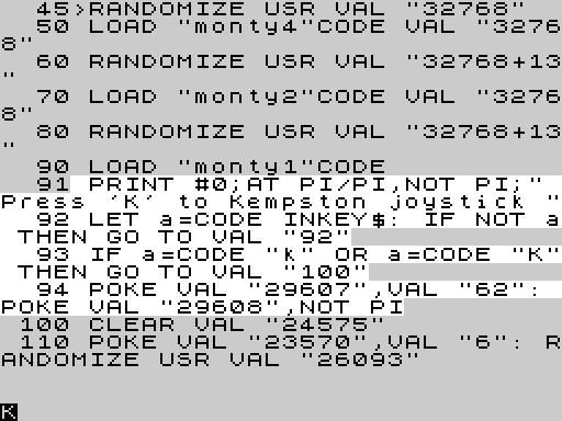

    Game contain bad joystick controll. Before start game must be tested joystick port. All ZX Spectrum computers and some other ZX clones not support kempston joystick port and IN A,(#1F) will always return #FF of attribute data from screen. All unused ports work as IN A,(#FF) !!!
    If joystick port is tested as inactive, you must disable joystick in game !
    kempston joy test example:
    HALT ;after interrupt ula draw border and on data bus is #FF value if unused port is readed
    LD BC,#001F
    IN A,(C) ;if you will read joystick via IN A,(c), then kemp.joy will work also on russian ZX clone SPRINTER
    AND #80 ;you can test only D7
    JR Z,GAME ;if D7=0 then joy is connect
    ;if D7=1 then joy port not exist = you must disable joystick port reading
    This game work only on ZX/clones with connected kempston joystick interface. Please fix if.
    It's possible fix also on ZX basic with POKE commands.
    Test joy in ZX basic:
    IF IN 31 > 127 THEN POKE xxx,xx .....
    It's fixed version - http://velesoft.speccy.cz/other/prel...pston_joy).zip
    (add one line in basic loader)
    Последний раз редактировалось VELESOFT; 04.09.2009 в 00:53.

    Цитата Сообщение от Barmaley_m Посмотреть сообщение
    Я даже думаю, что вместо теста на Kempston Joystick лучше дать пользователю выбор, использовать его или нет. Всякий тест использует некоторые предположения. В данном случае - что порт #1F не занят ничем другим, кроме Kempston. А это может быть не так.
    This can be also in ZX basic:
    10 PRINT "Press K for Kempston joystick"
    20 LET A=CODE INKEY$:IF NOT A THEN GOTO 20
    30 IF A=107 OR A=75 THEN POKE xxxx,xx ....
    40 GOTO STARTGAME
    This is PRELIMINARY MONTY with selectable kempston joystick.
    Only basic loader is modifiead (added some basic lines)
    LD BC,#001F
    ZIP file is updated. Yet is used better joystick testing in machine code.
    HALT
    IN A,(31) ;testing joy port after interrupt
    AND 128 ;test only D7
    LD BC,0
    RET Z ;return 0 of joy is connect
    INC BC
    RET ;return 1 if joy is disconnect
    Call from basic: IF USR xxxx THEN POKE (disable joy)
    PRINT #0;AT PI/PI,
    AT SGN PI
  7. #147
    06.06.2006
    г. Черкассы, Украина
    5,612
    672
    1,700
    463 сообщений
    8 Post(s)
    ну, тогда уж print #not pi; at sgn pi
    Ave ZX!
  8. #148
    14,318
    203
    1,482
    967 сообщений
    раз пошла такая пьянка - зачем указывать `AT` ?????
    достаточно просто print#not pi
    да и лоадер Tom-Cat сделал уж больно навороченный.
    Последний раз редактировалось goodboy; 06.09.2009 в 22:30.
  9. #149
    04.04.2007
    Praha
    753
    34
    15 сообщений
    Yes, in basic line can be used only PRINT #0 without AT.
    (I often use printing to screen lines 22 and 23 via PRINT #0;AT 0,0;"line number 22";AT 1,0;"line number 23"...)
