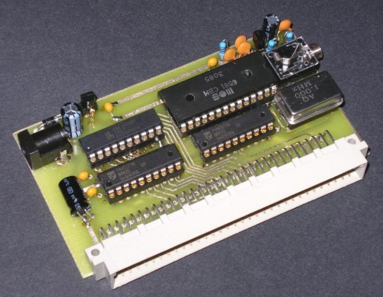

    This is my version of SIDINTERFACE
    15.06.2006
    S.Pb
    5,791
    VELESOFT, what ports are used?
    04.04.2007
    Praha
    753
    34
    15 сообщений
    This is 16bit ports. I must find manual. But you can see all ports on SID PLAYER source code:
    http://simonowen.com/sam/sidplay/
    See in schematic:
    8bit port #D4
    and A8-A12 + A15 select adress for SID chip.
    This port is unusable on real ZX Spectrums (collision wih port FE and 7FFD,etc...) but complette schematic and port decoder can be modified (integrated to one CPLD)
