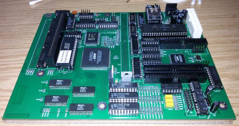

    I've gone with IDT 71024S15TYI since I could source them locally for cheap.
    Only waiting for the SIMM slot for now, then my Sprinter is complete

    Hey there, now that my SIMM slot has finally arrived (8 weeks delivery time) I started up my sprinter for the first time yesterday
    Works great so far, except that booting from disk isn't possible. I'm using this image from the velesoft site: https://velesoft.speccy.cz/sprinter/...age+writer.zip + rawrite3.com from freeDOS (http://www.ibiblio.org/pub/micro/pc-.../disk/rawrite/).
    On the DOS machine I can see the contents of the disk, but on the sprinter I get maybe 10 seconds of disk activity before the computer hangs. Very occasionally I get a reboot.
    What would be an alternative approach to make a HDD bootable? I successfully formated one of my drives on my DOS machine and copied everything from the Bootdisk over to the freshly formated partition, sadly that didn't work either.

    Shockwav3, The disc must be prepared directly on the sprinter.
    Here is the instruction https://zx-pk.ru/threads/10983-sprin...l=1#post879887
