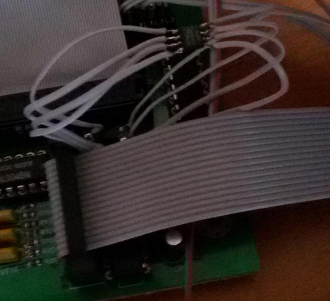

    Hm ... Beeper sound is fine, only AY sound appears to be broken.
    I've currently used this version of the BIOS (https://velesoft.speccy.cz/sprinter/...em/bios300.zip) ... maybe it's the wrong version?
    EDIT: Looks like I might have the same problem as Anubis and Tank-UK and ended up with Fake TDA1543 DACs (https://zx-pk.ru/threads/28420-kompy...ka/page10.html) ... just ordered some replacements.

    Second order were fakes as well ... I've helped myself by salvaging a TDA1387 from an older SoundBlaster16 soundcard and adapting the SMD to DIP ... now the sprinter sounds like it should (volume is a bit low, I guess).
    Well, this sucks ... no idea how to tell fakes from real ones. I've found a few stores which would very likely sell legit chips, but they have high minimum orders.

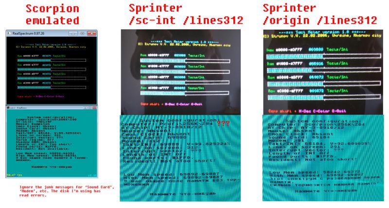

    What are the chances the BIOS might get an update in the future? I've pretty much managed to pinpoint the issue with Scorpion Timings.
    Looks like it is almost working correctly when selecting the "ZX Original" mode, but the lower RAM bank being contended/slow. With "Scorpion" mode the screen seems to set up incorrectly.

    \sprinter\LAST\BIOS\X_PLAN.txt from sprinter.zip (http://winglion.ru/sprinter/sp2000/sprinter.zip) also mentions this:
    NOW
          v Смеситель AY,Covox,Beeper
            Блокиратор CTRL-ALT-DEL
          ? Включение прерываний от клавиш с удержанием INT-а
            Запоминание состояния (CMOS-35h??)
            1. Переключатель конфигураций (BYTE)
                   V bit0 - 1 - accelerator on;  0 - accelerator off
                     bit1 -
                     bit2 -
                   * bit3 - 1 - AY - ABC;        0 - AY - ACB
                   * bit4 - 1 - Covox+AY+Beeper; 0 - Only-Covox;
                   * bit5 - 1 - Pentagon timing; 0 - Scorpion timing
                   V bit6 - 1 - Fast-Spectrum;   0 - Real-Spectrum;
                     bit7 -
    I guess the "Fast-Spectrum" mode would be what would come close to Scorpion timings (ZX Timings, but all RAM is "fast RAM").
