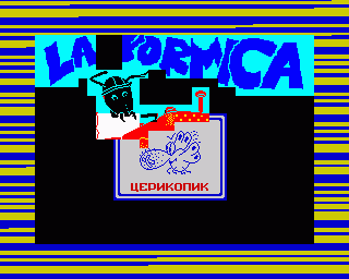

    Yes, I know. Try make WAV from my casette but this is very trouble :-(. I was able to record to WAV and LOAD to Spectaculator (over Virtual Audio Cable) with Winamp 5 (EQ ON 60Hz full) but not able load this to Compress Copy (L) (Parity)

    I convert to 22050Hz 8Bit Mono but Spectaculator wrong loading screen. If take load from Winamp with EQ some setting - all game La Formica loading OK :-) OK, I attach game (WAV) La Formica. Please help to make TAP from this :-)

    Link fixed :-) La Formica WAV
    P.S. Converted to 22050Hz 8bit Mono working in Spectaculator 7.51 (opened directly WAV i menu file) working loading screen but only if disable some option Cassette Recorder in Spectaculator:
    Fast loading, Flashloading and Edge detection
    Copy-Copy can not load block screens and Tape error :-(

    OK. I make WAV file 44100Hz, 8bit mono to open in Spectaculator. This working OK :-) But how convert this to TZX? This link is WAV and RZX file: La Formica
