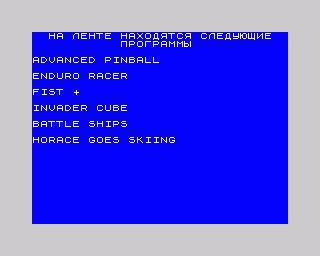

    I succesfully maked Side 2.tap file. Bytes: storona 2 is good from WAV, other blocks copy from Side 1.tap in ZX-Blockeditor and rename title storona 1 to storona 2 :-)
    P.S. At the end of the tape is this music. Probably this is from program WW (Byte-01 CP/M OS disk)

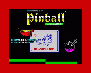

    Try this file
    1. Load game from 1Pinball.tzx
    2. Load screen from 2pinscr.wav

    DDp - you're great :-). Now all tape is backuped :-). Write how convert Pinball? Do you use my materials or other outside?
    This is all tape (fixed link) << Cerikopik >>
    Very THX for all :-)
