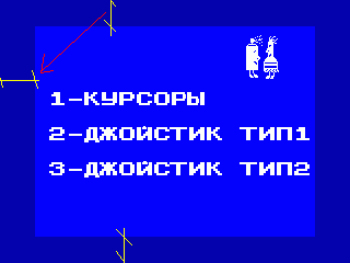

    WinXP SP2 have DirectX 9.0c default. ZXMAK2 need other update to fix the problem:
    directx_Jun2010_redist
    Is VI53 sound emulation working in "Byte"?
    I have suggestion. Please increase BORDER top and bottom in windowed 100%. Border size is not the same and it looks ugly.
    P.S. Sound emulation VI53 working in other emulator b2m but playing is too fast
    http://zx-pk.ru/showthread.php?t=20158&page=3

    Hi. I have problem to run ZXMAK2 in Windows XP SP2:
    This is because some components of the DirectX 9 is missing from your system. Just run the DirectX 9 Redistributable web installer and it will check, download and install all required components. The web installer is available on microsoft web site: http://www.microsoft.com/en-us/downl...ils.aspx?id=35
    ---------- Post added at 23:48 ---------- Previous post was at 23:38 ----------
    no, VI53 is not implemented yet.
    But memory emulation (with ROM remap feature) and ULA emulation (with multicolor and slow memory) is done.
    Also you need to disable tape traps and autoplay on the tape window to pass Tserikopik protection
    Yes it's working but I found one problem:
    1. Open Tape window
    2. Click anywhere in main window program e.g. menu File
    3. Now if you click icon Use Trap or Use Auto Play in Tape window this not switch on button
    4. Only when you click second time the same icon - button is switched
    For this reason, I had trouble loading the game with Cerikopik :-)
