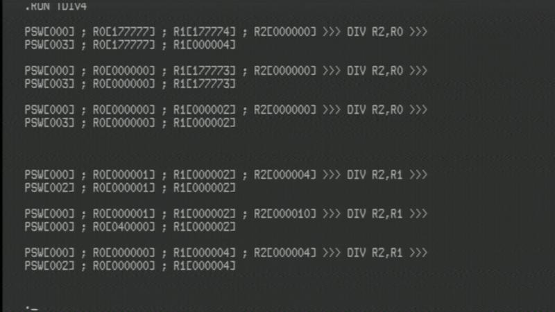

    В архиве TDIV+.zip :

    TDIV4.SAV - дополнительный тест деления на 0 и деления нечётного регистра для Эл.85 :
    .RU TDIV4
    PSW[000] ; R0[177777] ; R1[177774] ; R2[000000] >>> DIV R2,R0 >>>
    PSW[007] ; R0[177777] ; R1[177774]
    PSW[000] ; R0[000000] ; R1[177773] ; R2[000000] >>> DIV R2,R0 >>>
    PSW[007] ; R0[000000] ; R1[177773]
    PSW[000] ; R0[000000] ; R1[000002] ; R2[000000] >>> DIV R2,R0 >>>
    PSW[007] ; R0[000000] ; R1[000002]
    PSW[000] ; R0[000001] ; R1[000002] ; R2[000004] >>> DIV R2,R1 >>>
    PSW[002] ; R0[000001] ; R1[000002]
    PSW[000] ; R0[000001] ; R1[000002] ; R2[000010] >>> DIV R2,R1 >>>
    PSW[000] ; R0[000000] ; R1[000004] ; R2[000004] >>> DIV R2,R1 >>>
    PSW[002] ; R0[000000] ; R1[000004]
  6. #1025
    13.12.2013
    3,072
    37
    81
    65 сообщений
    Тест Эл.85

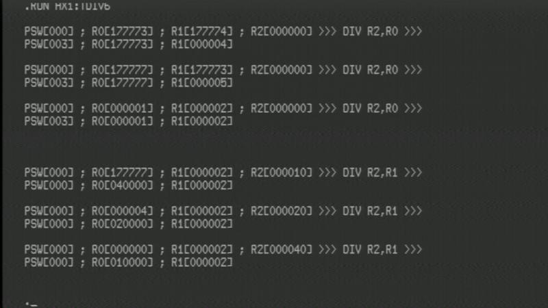

    Для продолжения тестирования - в архиве TDIV++.zip :

    TDIV6.SAV - дополнительный тест деления на 0 и деления нечётного регистра для Эл.85 :
    .RU TDIV6
    PSW[000] ; R0[177773] ; R1[177774] ; R2[000000] >>> DIV R2,R0 >>>
    PSW[007] ; R0[177773] ; R1[177774]
    PSW[000] ; R0[177777] ; R1[177773] ; R2[000000] >>> DIV R2,R0 >>>
    PSW[007] ; R0[177777] ; R1[177773]
    PSW[000] ; R0[000001] ; R1[000002] ; R2[000000] >>> DIV R2,R0 >>>
    PSW[007] ; R0[000001] ; R1[000002]
    PSW[000] ; R0[177777] ; R1[000002] ; R2[000010] >>> DIV R2,R1 >>>
    PSW[000] ; R0[000004] ; R1[000002] ; R2[000020] >>> DIV R2,R1 >>>
    PSW[000] ; R0[000000] ; R1[000002] ; R2[000040] >>> DIV R2,R1 >>>
