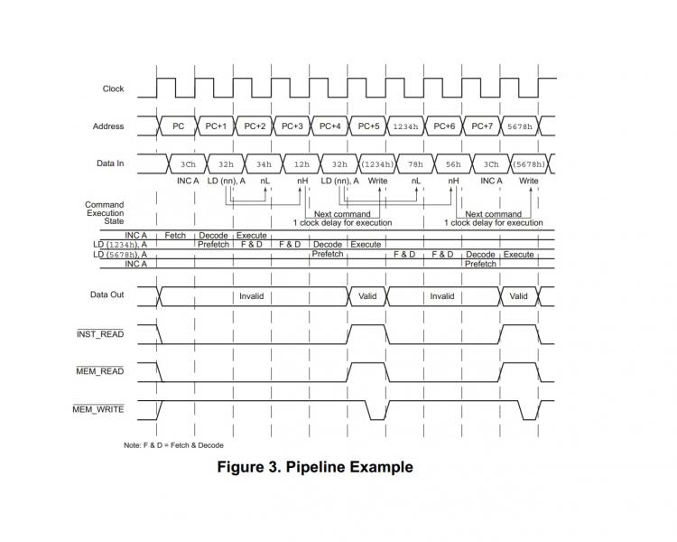

    Может кто нить знает как работает конвейер команд в eZ80? Может получиться добавить, возможно удастся ещё увеличить его производительность.
    Нашёл только такое упоминание (картинки прикрепил к посту)
    http://www.zilog.com/docs/um0077.pdf
    Pipeline Description
    The CPU pipeline reduces the overall cycle time for each instruction. In principle, each instruction must be fetched, decoded, and executed. This process normally spans at least three cycles. The CPU pipeline, however, can reduce the overall time ofsome instructions to as little as one cycle by allowing the nextinstruction to be prefetched and decoded while it executes the current instruction as displayed in Figure 2. The CPU operates on multiple instructions simultaneouslyto improve operating efficiency.
    In Figure 3, the pipelining process is demonstrated using a series of nstructions. The first LD instruction prefetches its opcode and first operand during the decode and execute phases of the preceding INC instruction. However, the second LD instruction in the sequence only prefetches its opcode. The bus WRITE during the execute phase of the first LD instruction prevents the pipeline from prefetching the first operand of the next instruc-tion. Thus, the number of bytes prefetched is a function of the command currently execut-ing in the CPU.
    When a control transfer takes place, the Program Counter (PC) does not progress sequen-tially. Therefore, the pipeline must be flushed.All prefetched values are ignored. Control transfer can occur because of an interrupt or during execution of a Jump (JP), CALL, Return (RET), Restart (RST), or similar instruction. After the control transfer instruction is executed, the pipeline must start over to fetch the next operand.
    Хотел бы ещё добавить к обсуждению части участников в теме - всё это только теория, не судите строго.

    И что мы получаем? Тот же пень, только на основе кода z80, а не 8086. Смысл? Только если в самом процессе разработки.

    Этим идеям до пней очень далеко, даже до i386 тоже. Рассматривается как бы апгрейд проца Z80 в "расширенный" 32 битный режим Z380. Но толку от 32 битного режима без управления памятью будет мало.
    Если посмотреть историю развития процессоров в том числе Zilog, то многие пошли по пути аппаратного управления страницами, защитой и уровнями привилегий.
    Не помню кто в теме писал, что при запуске одной программы мы получим CP/M.
    Допустим напишем мы многозадачный CP/M, как распределять память между программами если все программы находятся в одной и той-же памяти? Можно конечно, но надёжность системы будет низкой - никакой гарантии что кривая программа или драйвер не завалит всю систему.
    Судя по всему при развитии процессоров, часть функций ОС по управлению памятью и процессами переложили на CPU. В итоге получили грамотное управление процессами, памятью, повысили надёжность системы. Вот собственно и появилась идея дополнить Z80 процессор необходимым функционалом, чтобы эффективно использовать 32 битный Z380 режим.
