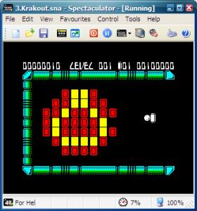

    OK, working but without ВИ53.
    Moreover BEEP sound is too strong and palete colour is faded, maybe only other than Spectaculator
    No. I see that you have opened .sna file and emulator has selected another configuration (ZX Spectrum 128). At this moment there is no possibility to open .sna in Byte configuration. You can only start Byte in "New..." dialog box and load .tap or .tzx with command LOAD "".

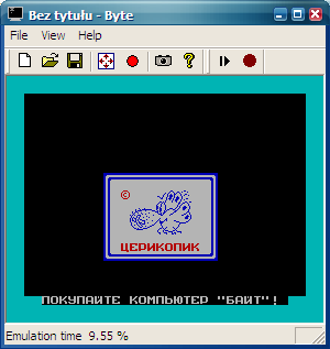

    OK, VI53 I think working :-) but Tserikopik from ART STUDIO (Hudoznik with lambada) stop LOAD :-(
Название:	VI53 no Byte ROM.png
  5. #15
    24.01.2008
    Уфа
    3,926
    105
    290
    216 сообщений
    If it has special loader you can try to load it without interception of read byte procedure:
    1. type LOAD "" but do not press Enter key
    2. on the toolbar press "play" button and select the .tap file
    3. after that press Enter key immediately
    4. during the loading you can press and hold F9 to speed up the loading

    КР580ВИ53 working :-) but some problems need fix in emulator:
    Only TZX file is possible to open in list. A have TZX file Art Studio from this:
    http://zxbyte.ru/doc/tape/tzx1991.zip
    Next problem is loader Nu pocitaj (game instruction) after press Enter several times auto open dialog Open file in emulator.
    This problem solved in Tapir - deleted some first block's from tzx file but Cerikopik not load and "Pakupajtie komputer Bajt" and BEEP, BEEP, BEEP ... :-(
    1. How open TAP file's?
    2. How rewind and fast forward tape or tzx files?
    3. How load game protected Cerikopik procedure?
    Последний раз редактировалось Gelip; 19.10.2012 в 08:13.

    1. "On the fly" convertion of the .tap file is not supported yet
    2. Nohow. Maybe i add this feature in the future
    3. I can't say right now, i have not tried yet
    My emulator is not perfect... yet
    ---------- Post added at 10:53 ---------- Previous post was at 10:38 ----------
    I have read this: http://zxbyte.ru/byte23.htm
    The Cerikopik protection procedure compares timing of execution in RAM and ROM. The correct timing is not realized.

    Prusak share Cerikopik protection removed from oryginal version Art Studio:
    http://zxbyte.ru/doc/tape/tzx1991unprotect.zip
    Lambada working but playing is too fast. I attach video :-)
