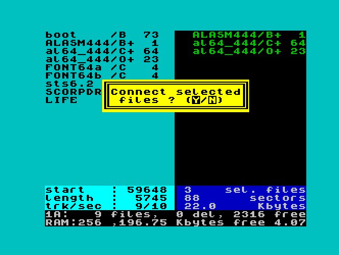

    To join several files into one big file you can use Direct commander. Press S, select some files (there must be no space between files), press Z and confirm operation Y(es).
