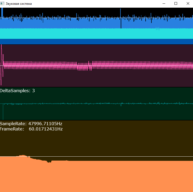

    Продублирую.
    Windows 10, монитор Viewsonic vp930
    Окно консоли на 50 hz :
    EmuStudio 0.9 test 1 (ZX-Mode)
    Written by dr.Titus 2006,2025
    CPU: AMD FX(tm)-8120 Eight-Core Processor
    Support: MMX SSE SSE2 SSE3 SSSE3 SSE4.1 SSE4.2 AVX
    Logical CPU cores: 8
    Current CPU #0 frequency: 3100MHz
    DWM Composition: Enabled
    Powered from AC
    Power scheme already exist
    Low CPU AC threshold = 90%
    Low CPU DC threshold = 20%
    Power scheme activated
    WM_CREATE
    Windows version: 10 (10.0.19041.5072)
    Multimedia timer resolution: 2057 mks
    Multimedia timer resolution: 1997 mks
    Desktop DPI: 96 dpi (scale: 100%)
    DXGI version 1.6
    Direct2D version 1.3
    Monitor[0] - NVIDIA GeForce 9800 GT : VP930 Series
    Mode: 1280 x 1024, 60.020000Hz
    Frequences set: 60.02Hz, 75.03Hz
    Hardware composition: not supported
    Adapter[0]: Direct3D feature level 10.0
    Allow tearing (variable framerate): supported
    Shader model 5.0 not supported!
    WASAPI system mix format: 48000 Hz, 32 bits, 2 channels, float
    Endpoint name: Наушники (High Definition Audio Device)
    WASAPI endpoint format: 48000 Hz, 16 bits, 2 channels, PCM
    Audio system: WASAPI Shared
    Audio format: 48000 Hz, 32 bits, 2 channels
    Device minimum period: 2 ms
    Audio Buffer Size: 1056 samples (22.0 ms)
    480, 0, 0, 0, 480, 0, 0, 0,
    Process priority: 128
    Main thread priority: 0
    High resolution timer: 10000000Hz
    CPU Mode: Pure
    WMI thread priority = -15
    Emulation thread priority = 2
    Audio thread priority = 15
    Audiobuffer padding: 29.1 ms
    Total audio delay: 48.4 ms
    Audio buffer is empty
    Video thread priority = 1
    Class name WIND_0000
    Init: Pentagon
    Snapshot snapshot.z80 loaded
    SoundProfiler: Init
    Viewport size changed: 812 x 572
    Frames lost: 2
    Resync
    *********@.@SoundProfiler: End

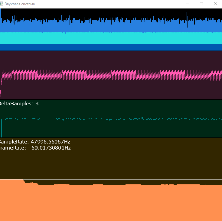

    На 100 Hz
    Powered from AC
    WM_CREATE
    Multimedia timer resolution: 1962 mks
    Multimedia timer resolution: 1950 mks
    DXGI version 1.6
    CPU Mode: Pure
    Audiobuffer padding: 58.3 ms
    Total audio delay: 85.9 ms
    Init: Pentagon
    SoundProfiler: Init
    Frames lost: 2
    Resync
    ***@********SoundProfiler: End
    Скрин:
    100 Hz
    Моё железо
