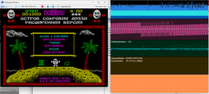

    Задача теста:
    1. Заскриншотить окно анализатора звука, когда оно заполнится почти целиком и прислать сюда.
    2. Заскриншотить окно консоли (копипастой) и тоже прислать сюда.
    EmuStudio v0.9 test 1 (50Hz, AudioBuf 0.5 frame).exe
    EmuStudio 0.9 test 1 (ZX-Mode)
    Written by dr.Titus 2006,2025

    WM_CREATE
    Windows version: 11 (10.0.22621.4830)
    Multimedia timer resolution: 2431 mks
    Multimedia timer resolution: 2008 mks
    Desktop DPI: 96 dpi (scale: 100%)
    DXGI version 1.6
    Direct2D version 1.3
    Monitor[0] - NVIDIA GeForce GTX 970: 27G2G5
    Mode: 1920 x 1080, 74.973000Hz
    Frequences set: 50.00Hz, 59.94Hz, 60.00Hz, 74.97Hz
    Hardware composition: fullscreen / cursor stretched
    Monitor[1] - NVIDIA GeForce GTX 970: 2769M
    Mode: 1920 x 1080, 60.000000Hz
    Adapter[0]: Direct3D feature level 11.1
    Allow tearing (variable framerate): supported
    WASAPI system mix format: 96000 Hz, 32 bits, 2 channels, float
    Endpoint name: Динамики (5- USB HIFI AUDIO)
    WASAPI endpoint format: 96000 Hz, 24 bits, 2 channels, PCM
    Audio system: WASAPI Shared
    Audio format: 96000 Hz, 32 bits, 2 channels
    Device minimum period: 3 ms
    Audio Buffer Size: 2112 samples (22.0 ms)
    0,  0,  0,  0,  960,  0,  0,  0,
    Process priority: 128
    Main thread priority: 0
    High resolution timer: 10000000Hz
    CPU Mode: Pure
    WMI thread priority = -15
    Emulation thread priority = 2
    Video thread priority = 1
    Audio thread priority = 15
    Audio buffer is empty
    Audiobuffer padding: 3.3 ms
    Total audio delay: 21.0 ms
    Class name WIND_0000
    Init: Pentagon
    Snapshot snapshot.z80 loaded
    Frames lost: 1
    Viewport size changed: 812 x 572
    *Resync
    SoundProfiler: Init

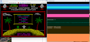

    Моники поддерживают 50Гц. Лучше было бы на этой частоте попробовать)
    CPU: AMD FX-8370 Eight-Core Processor
    Support: MMX SSE SSE2 SSE3 SSSE3 SSE4.1 SSE4.2 AVX
    Logical CPU cores: 8
    Current CPU #0 frequency: 4000MHz
    DWM Composition: Enabled
    Powered from AC
    Power scheme already exist
    Low CPU AC threshold = 90%
    Low CPU DC threshold = 20%
    Power scheme activated
    WM_CREATE
    Multimedia timer resolution: 1989 mks
    Multimedia timer resolution: 2014 mks
    DXGI version 1.6
    Mode: 1920 x 1080, 50.000000Hz
    0,  960,  0,  0,  0,  0,  960,  0,
    CPU Mode: Pure
    Audiobuffer padding: 5.0 ms
    Total audio delay: 26.0 ms
    Init: Pentagon
    Resync
    SoundProfiler: Init
