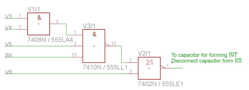

    Seems like I at least figured out how to reproduce the Timing of the machine in UnrealSpeccy
    Check even M1
    Check 4T Border
    (possibly) Check Port FF - likely not implemented, at least HorrorFasTest doesn't detect it
    T-States per INT: 69888
    T-States per Line: 224
    Start of Paper: 12552
    Int fq: 50
    Int len: 32

    Figured out a solution
