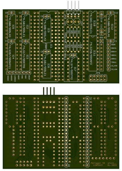

    First proposal for a layout ... includes 128K mem muxing, INT fixes, Kempston joystick + AY (short 128MIKAY)
    If there are no objections I'd upload the gerber files + schematic so they can be produced (would make little sense in my understanding to do it myself and mail 90% of the boards off to russia [considering mail from Germany to Russia is quite expensive]). Reason for including the Kempston interface is the fact that the one on the P48 needs some fixing (pullups) and that the 8255 can be left out this way. Reason for not including the SRAM mod is the fact that the PCB would get too large when including 2 more 600mil DIPs.

    First release. Feedback is welcome.
    MIKAY128_release_099.zip

    Буду пробовать сделать это расширение. У кого-нибудь есть лишние платы?
    I will try to make this expansion. Does anyone have unnecessary PCBs?
    Заказал в китае. В гербере указаны 4 слоя, хотя дорожки реально только на 2х, заказал двухслойную.

    Использовал данную плату для реализации AY+Kempston joystick на Pentagon-128 (собран по схеме от Mick ). Для Pentagon-128 вместо сигнала IORQ использовал OIRQ c pin 6 DD85.2 иначе не будет работать BDI.
