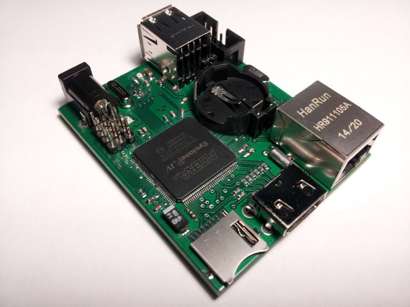

    ReVerSE U16
    Спецификация:
    • FPGA Cyclone IV EP4CE22E22C8N (supports Cyclone III EP3C5/10/16/25, Cyclone IV EP4CE6/10/15/22)
    • SDRAM 16MB x 16 bit (supports 4/16/32MB x 16 bit)
    • FLASH 2048KB (supports 2048/512KB)
    • RTC DS1338Z + CR2032
    • HDMI for sound and video (DVI or HDMI Male to VGA HD-15 15Pin Male Adapter Cable Cord)
    • 10/100 Base-T Ethernet interface controller ENC424J600 with integrated MAC & PHY
    • Dual USB 2.0 Host / Slave controller VNC2 (2 x ports)
    • micro SD
    • JTAG
    • GPIO (uBUS)
    • Power +5В 1A
    • PCB Size 70 х 56 mm
