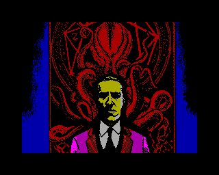

    новая игра от Cebrian - Lovecraft Mythos
    пост на SC
    официальный сайт

    У меня при загрузке на реале 48К, постоянно замкнут прыжок. Таким образом в меню ниже второго пункта опуститься невозможно и в самой игре персонаж постоянно скачет. У кого-нибудь такое было?

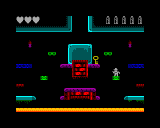

    новая версия - beta4.
    * A difficulty selector. In easy mode bullets give you three times more ammo, and pickups are more frequent.
    * Health pickups, which should only appear under dire circumstances.
    * Night Gaunts are now slower and have some limited ability to circumvent obstacles.
    * An intermission screen (to retry a level). Now starting the game from the main menu always starts in the first screen.
    * A new ending screen for easy mode
    * The three last screens are now different as they were too unfair.
