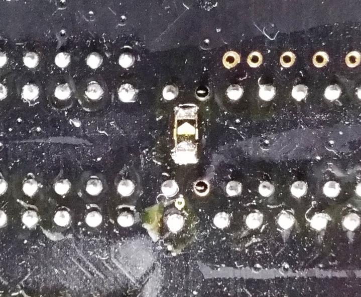

    My PCB not assembled yet, so, I can't help you. Did you fit smd diode on the bottom side of PCB?

    Where is that one located on the 2019 board? In case it's the one that goes to the 22v10 GAL or the KS156, yup I did fit those.

    Anode of SMD diode connected to 24 pin of CPU (WAIT-), stil can't trace link for cathode, seems to be VD2 КД522 on diagram. Try to check yourself!

    That will be connected to one of the 22v10 GALs (the one programmed with turbo.jed)

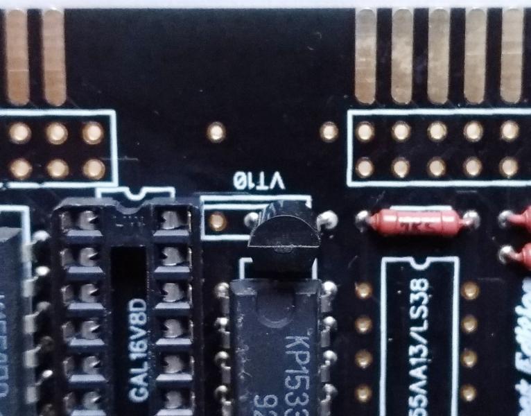

    Цитата Сообщение от andreysur Посмотреть сообщение
    How to fit V10 KT209 (BC547)[/url]
    Вложение 70259
    This is incorrect, it should be a BC557 (PNP just like KT209)

    Sorry, it's my mistake! Fixed it.
