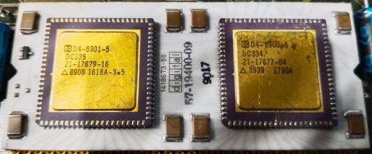

    http://www.ibiblio.org/pub/academic/...p-11/hardware/
    Файл kdj11_2
    Цитата оттуда:
    "The highest rev J11 that's out there *should* be the -9 part (look on the white ceramic base for a 21-xxxxx-09 part number. The numbers on the gold-cap elements aren't really relevant to this. A -9 part runs at 18Mhz, has a working warm floating point, and supports the FPJ11 hot floating point properly. Earlier revs run at slower speed and/or have broken FP and/or instruction set bugs. Just about all combinations exist (I have a complete set from -3 through -9) A -9 is a DCJ11-AE while most of the earlier numbers are DCJ11-AC."
    Ключевые моменты:
    - look on the white ceramic base for a 21-xxxxx-09 part number. The numbers on the gold-cap elements aren't really relevant to this
    - I have a complete set from -3 through -9

    Фото вроде -05-ого
    http://brainstones.narod.ru/collecti...7_19400_05.jpg
    Не обратил сразу внимание - на микросборке стоит маркировка DCJ11-AD
    30.11.2015
    г. Самара
    7,557
    346
    720
    602 сообщений
    Нашлось фото -06 варианта
    https://upload.wikimedia.org/wikiped...ro-380_CPU.jpg
    Получается, пока под вопросом -00, -01, -02 и -03
