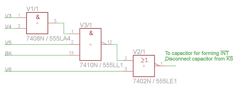

    Hi there,
    I've currently assembled another russian clone a "Compact 256 Turbo" from a PCB I bought. The machine appears to be fully functional and overall has a decent feature set. The machine seems to be largely inspired by either the KAY-256 or Scorpion 256.
    Considering I already have a Pentagon 128 and the Scorpion 256 being the other "major" russian clone, I'm highly interested in fixing the Timing so I can watch Scorpion 256 Demos on the Compact 256. Timing seems to be largely compatible (69888 T-States per INT, 295/312 Lines on Screen, waitstates). Only problem I encountered is that the "start of paper" is about 8 lines off (12552 vs. 14344 if you want to reproduce them in UnrealSpeccy). You can see it on this simulated screenshot which perfectly matches up with the Compact (Top is Scorpion Timings, Bottom is Compact):
    https://i.imgur.com/kPZVz1a.jpg
    As you can see the Border gets drawn a bit too early (uppermost line is supposed to be red) resulting in a 8 Pixel offset between Border and Screen. Demo used is "Cool Suxx" by Flash Inc downloadable here: https://zxaaa.net/view_demo.php?id=5847
    Other Scorpion Multicolor demos show similar problems.
    Any ideas how to fix that? I've looked into the schematic and adapted how !INT is triggered, but with no change. Personally I'd love to understand how the Signals SS (related to Composite Sync I think), !KS, !BS, BK, !SCR relate how the video output is formed.
    Documentation:
    Schematic for Compact 128 here (that machine has a partially different schematic, but the very same problem): http://zxspectrum.it.omegahg.com/Com...OMPACT-128.pdf
    PCB Top: https://cloud.mail.ru/public/Hzag/XQtJ8YHTJ
    PCB Bottom: https://cloud.mail.ru/public/FPQA/XMBg7q5uS
    - - - Updated - - -
    Inverting !KS before going to the capacitor + RD gate slightly improved things. Now TestINT 1.10 is drawing the grey bar right between ZX/ZS and Pentagon Timings (previously it was under the ZX bar).

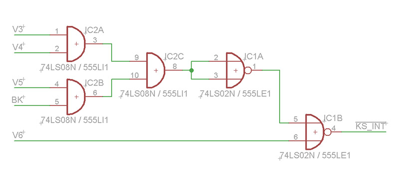

    Found a solution that works
    Final implementation on board:
    Simplified Schematic:
