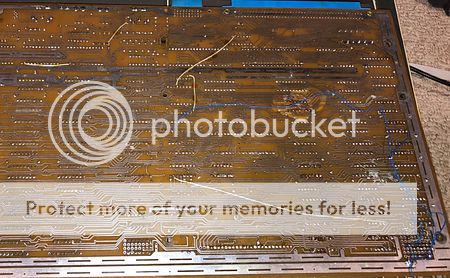

    Take a good quality photo of the underside of the board.
  2. #22
    12.08.2020
    Washington, USA
    28

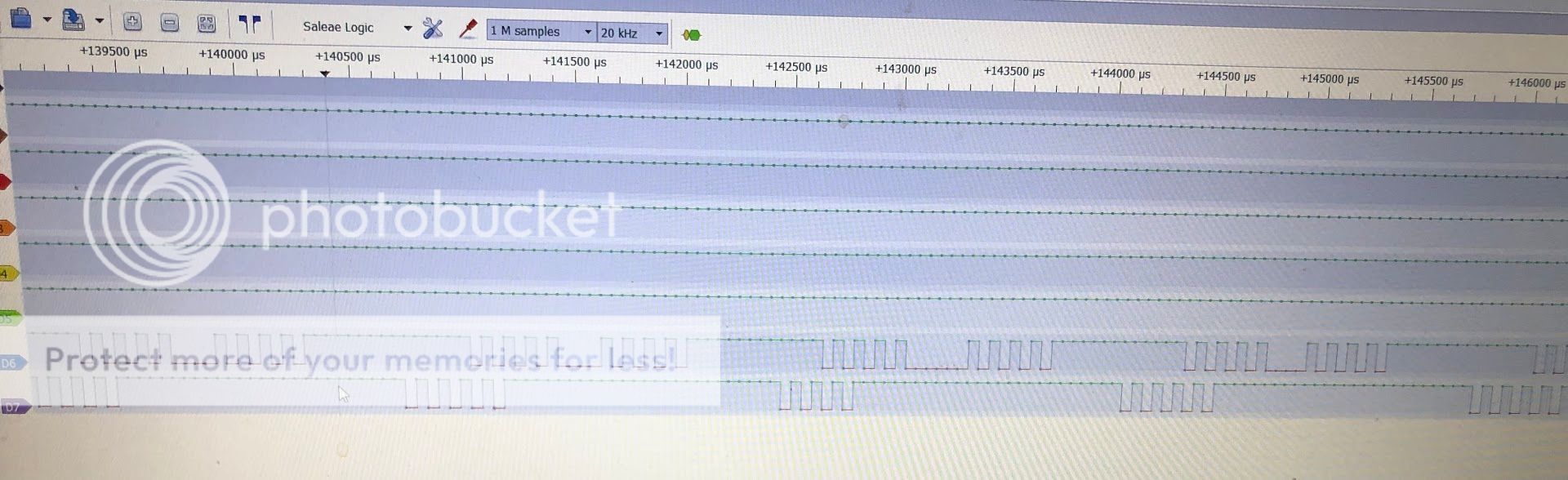

    Thank you. This is what I see on pin 15 of the RAMs. I don't think that's right!
    The blue wires are my additions. I also scorched the board a bit when I removed a chip with a heat gun.

    https://s8.hostingkartinok.com/uploa...654693fdb7.jpg
    Marked in yellow where you need to clean.
    Marked in red, I can't see.

    I cleaned all three areas up with rubbing alcohol until they were shiny, and I verified none of the traces were broken from corrosion. Unfortunately it didn't make any difference.

    In fact this could be a regeneration cycle (pin 15 is CAS, inverted)
    Can you monitor pin 4 (RAS, inverted) along with pin 15?
    Pin 4 should be low and pin 15 should be high to trigger regeneration.
    But anyways the low frequency "envelope" on your screenshot from the oscilloscope does not look good at all.

    Channel 6 is pin 4, channel 7 is pin 15, so it seems like it's regenerating.
