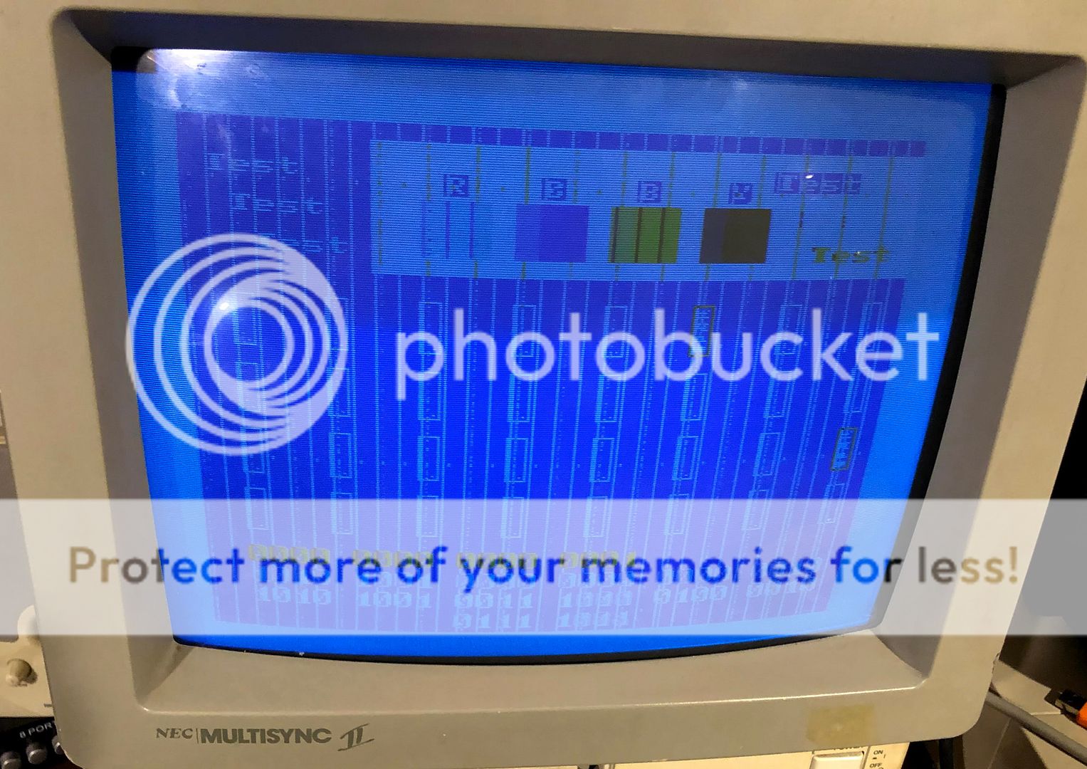

    Success! It now boots, but the colors seem inverted. The background is yellow and the lines are blue. I'll try connecting the resistors directly to the inverters as in the schematic, but last time I tried that I only got a white screen. I'll also try to load that test program, other RAM may possibly be bad. Thanks everyone for your help.

    It looks like it found two more bad RAMs. D78 and D64?
    Same result with second utility
    EDIT: I replaced the two bad RAMs, it's booting fine now. I loaded a few games and they seem to work other than the colors being wrong.
    EDIT 2: I rewired the resistors to the inverter as per the instructions and now I get a perfect picture.

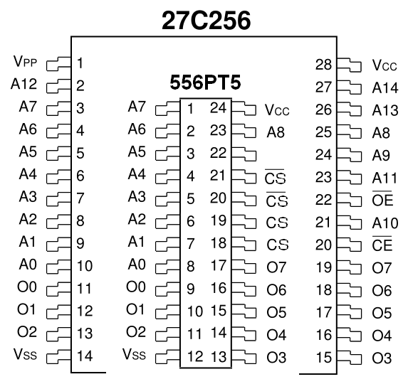

    D9 is a PT5, the 512 byte ROM. Are there instructions on how to upgrade this to a larger ROM? Since it uses two Chip Select lines I'm not sure if I could directly replace it with a 27256? I'd definitely like to use the "Combodevice" so I can load software faster and try out some Demos.
    I already gave a link to the instructions for replacing the ROM.
    You can change it to any ROM, I wrote that now 27512 is installed on my computer, and previously I installed 290011. I installed a socket in the computer and change the microcircuit when necessary. I installed jumpers on the ROM, and several different programs were written into it at once.
    cyb2600, write what kind of ROM you have, here they will tell you how to connect it.

    I have blank 27256 and 27512, I can use either.
    There are a lot of options for improvement.
    ROM pin mapping.
    https://s8.hostingkartinok.com/uploa...b5d7c3d99c.png
    I suggest installing a 28-pin socket on the board to install the ROM.
    Pins: 1, 2, 20, 21, 23, 24, 27, 28 - bend the leads, do not solder them into the board, isolate them from the board contacts.
    Connect pins 26 and 28 (A13 always "1").
    Connect old pin 21 - new pin 20.
    Connect new pin 21 and D1 pin 17 (A10).
    Connect new pin 24 and D1 pin 18 (A9).
    Connect pins 23, 2, 27 to jumpers to select a program (for 8 program of 2K).
    Рrograms will need to be written to the ROM from the addresses:
    A14="0":
    2000h
    2800h
    3000h
    3800h
    A14="1":
    6000h
    6800h
    7000h
    7800h
    It is not necessary to connect free address pins (23, 2, 27) with jumpers, you can connect them to the power supply or the case, and write only one program to the ROM.
    The corner at the first contact of the socket will need to be cut, since chip D1 will interfere.
