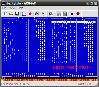

    I found interesting thing in EMU 1.01 (Башкирия-2М) on WinXP SP2 NTFS file system. From emu Orion-Pro 2 possible access to real disk or folder on Windows XP :-):
    Need these files:
    1. Unpack EMU and files e.g. on Desktop
    2. Run EMU, select Orion-Pro 2 and from red menu select Orion-PRO
    3. Now have error: BDOS ERR ON A: SELECT
    4. In drive 1 mount file DISK01P.ODI and press Enter. If still error displayed try mount one more time this file. Must be prompt A>
    5. Now run Norton Commander, type nc and press Enter
    6. Press TAB to go to right window nc
    7. In drive 2 mount file DISK1.ODI, press D and select disk B
    8. In drive 2 mount file disk.kdi (selecting All files), press D and select disk B
    In this moment in right window Norton Commander is access to real folder on PC - Desktop in this example :-) and possible change file name, delete files etc.
    Please Comment!
    Please Comment!
    При удалении файлов на Орионовском диске реально удаляются живые виндовозные файлы?

    Yes, path B:\User 0 in NC right panel emulator Orion is path in Windows C:\Documents and Settings\user_name\Desktop
    Path in right panel NC = path where is disk.kdi file located. In my case file disk.kdi is on Desktop.
    Possible delete, rename files etc.
