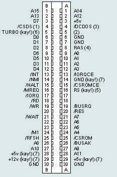

    Now the ex Soviet Union standard ZX Spectrum bus - NemoBus. NemoBus - is a modified bus ZX Bus. NemoBus - this is not the Russian standard, this standard ex Soviet Union. NemoBus used in all computers KAY, Pentagon-1024SL v1.4, v2.2. A computer Scorpion ZS256/Turbo+ is not used NemoBus, there is clone ZX Bus. The main difference NemoBus of ZX Bus - the existence of arbitration. Slots NemoBus not the same, highest priority is the 1 st slot, the 3rd slot is the lowest priority. To work NemoBus are most familiar to the original scheme of computer KAY-1024SL:KAY-1024.rar

    Try this...
    04.04.2007
    Praha
    753
    34
    15 сообщений
    Try this...
    This is very similar as original ZX Spectrum BUS
    Pinout of main signals(from CPU) is same.
    You can connect interface designed for original ZX models to russian ZX clones with this ZX bus layout.
