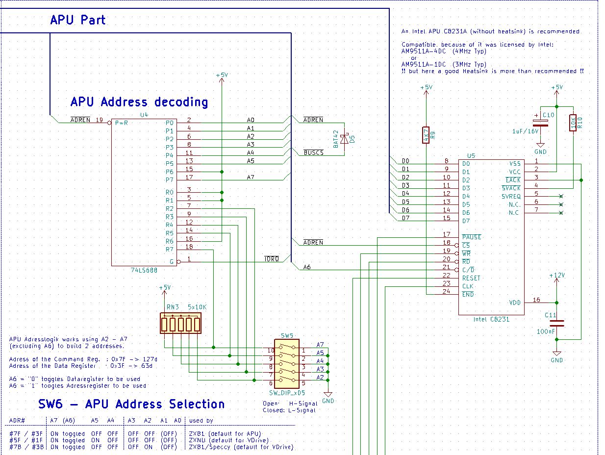

    набрел здесь на заметку, о подключении 8231 к спектруму, пишут из старого немецкого журнала
    схемка
    I'm probably able to give you some hints because of... a couple of weeks ago I started to build a Sinclair ZX / ZX81 APU Prototyp card based on an article of an old German computer magazin.
    So even that the ROM seems to be missing on your card you are probably able to use the card with some Basic coding as we started here in Germany to do some simple tests.
    APU Intel 8231A or AMD AM9511A are pin compatible
    So beside some coding we started with using the original Spectrum ZX ROM without any changes:
    Used I/O Addresses to communicate with the APU are as follows, while the APU is using two registers for the calculation(s): a Data- and a Command Register
    D=Data-Adresse = 31d -> 1Fh (or 125d -> 7Dh)
    C=Command-Adresse = 95d -> 5Fh (or 127d -> 7Fh)
    in our case we toggle address bit A6 to switch between Data and Command register (see my attached schematic snapshoot), so the Apple I/O Addresses needs to be used here, instead.

    Arithmetic APU Operation -> 16 Bit Addition: Command 108d -> 6Ch
    PROGRAM: APU-Test
    100 REM TESTPGM 8231A or AM9511A APU
    110 LET C=95: LET D=31 REM 95d = Command Register; 31d = Data Register
    120 OUT D,10: OUT D,0 REM load value 10 to the APU
    130 OUT D,20: OUT D,0 REM load value 20 to the APU
    140 OUT C,108 REM use APU command 108d -> 6Ch to do a 16nd Bit Addition
    150 LET A=IN D: LET B=IN D REM get calculation result(s)
    160 PRINT A REM A should held 0
    160 PRINT B REM B should held 30 -> which is the result of 10 + 20 (see above)
