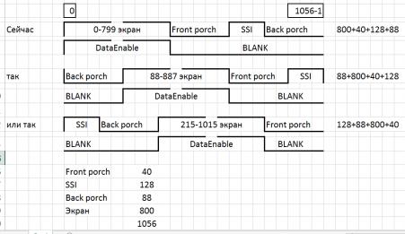

    HardWareMan, не все проще , я пропустил что ты нормальный blanc сделал а не мой disp_enable, счас все работает.
    У меня же и HDMI с инвертированным blanc.
    Позже перепишу ...
    Счас так:
    module vga_sync(
    input clk_in,                    // Input 40 MHz clock, this is a pixel clock for this VGA mode
    input reset,                     // Input async. active low reset signal
    output reg vga_hsync,            // Output horizontal sync signal
    output reg vga_vsync,            // Output vertical sync signal
    output reg disp_enable,          // Set when a writable portion of display is enabled:
    output reg[9:0] pix_x,           //  x-coordinate of an active pixel
    output reg[9:0] pix_y,            //  y-coordinate of an active pixel
    //output reg[19:0] v_addr,       // VRAM address count
    output wire[7:0]  data_out
    localparam SYNC_ON  = 1'b1;      // Define the polarity of sync pulses (psitive)
    localparam SYNC_OFF = 1'b0;
    localparam HSYNC_START = (840-1);
    localparam HSYNC_END   = (968-1);
    localparam LINE_END    = (1056-1);
    localparam VSYNC_START = (601-1);
    localparam VSYNC_END   = (605-1);
    localparam FRAME_END   = (628-1);
    localparam  H_ACTIV     = 800;
    localparam  V_ACTIV     = 600;
    reg [7:0] vram [0:4095]; initial $readmemh("vram.dat", vram);
    reg[9:0] line_count;             // Line counter, current line
    reg[15:0] pix_count;             // Pixel counter, current pixel
    reg[19:0] v_addr;                // vaddres counter
    reg [1:0]SynRes;
    always @( posedge clk_in )
    begin
       // reset
       SynRes[1:0] <= {SynRes[0],reset};
    	// pixel count
    if ( (SynRes[1] & ~SynRes[0]) | (pix_count == LINE_END) ) pix_count <= 0; else pix_count <= pix_count + 1;
       // line count
    if ( (SynRes[1] & ~SynRes[0]) | (line_count == FRAME_END ) ) line_count <= 0;
       else if ( pix_count == LINE_END ) line_count <= line_count + 1;
    	// synhroimpulse
    if (SynRes[1] & ~SynRes[0]) begin vga_hsync <=0; vga_vsync<=0; end
    if(pix_count== HSYNC_START)vga_hsync <= SYNC_ON;else if (pix_count==HSYNC_END)vga_hsync<=SYNC_OFF;
    if(line_count== VSYNC_START)vga_vsync <= SYNC_ON;else if (line_count==VSYNC_END)vga_vsync<=SYNC_OFF;
    if (SynRes[1] & ~SynRes[0])  v_addr <=0;// or this: if (SynRes[1:0] == 2'b10)
    if ( pix_count < H_ACTIV ) pix_x <= pix_count;  else pix_x <= 0;
    if ( line_count < V_ACTIV) pix_y <= line_count; else pix_y <= 0;
    //disp_enable <= ~((pix_count < 800) & (line_count < 600));
    disp_enable <= ((pix_count < H_ACTIV) & (line_count < V_ACTIV));
    if(disp_enable)v_addr <= ((pix_y*H_ACTIV)+pix_x);
    end
       assign  data_out = vram[v_addr];
    endmodule
