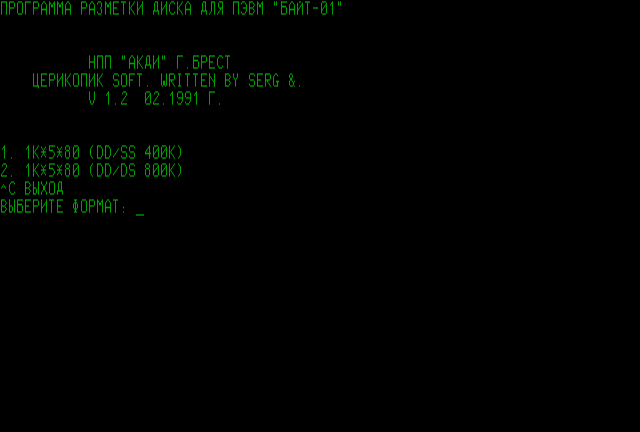

SYSGEN.COM offset 1400:
This is cpm_sys.kdi image:Код:$ 1024*5*80 S2 DD-DS 776K
$ 1024*5*80 S3 DD-SS 380K
$ 1024*5*40 S3 DD-SS 182K
$ 512*9*80 S2 DD-DS 698K
$ 512*9*40 S2 DD-DS 338K
$ 512*9*80 S3 DD-SS 342K
$ 512*9*40 S3 DD-SS 164K
$ 256*16*80 S2 DD-DS 620K
$ 256*16*80 S3 DD-SS 304K
$ 256*16*40 S3 DD-SS 146K
$ 1024*5*80 korwet DD-DS 780K
$ 1024*5*80 korwet DD-SS 790K
Код:Offset Description
00000 - 04FFF Probably CP/M OS
05000 - 05FFF File (directory) structure
06000 - 1DFFF Files CP/M OS
1E000 - 21FFF ZX Spectrum 48 original ROM (SYS2.OVL)
22000 - 25FFF TR-DOS 5.01 (SYS3.OVL)
40500 - end file empty E5 E5 E5...

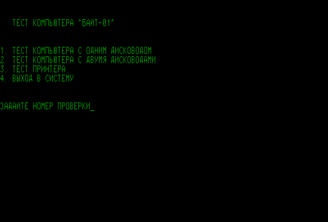

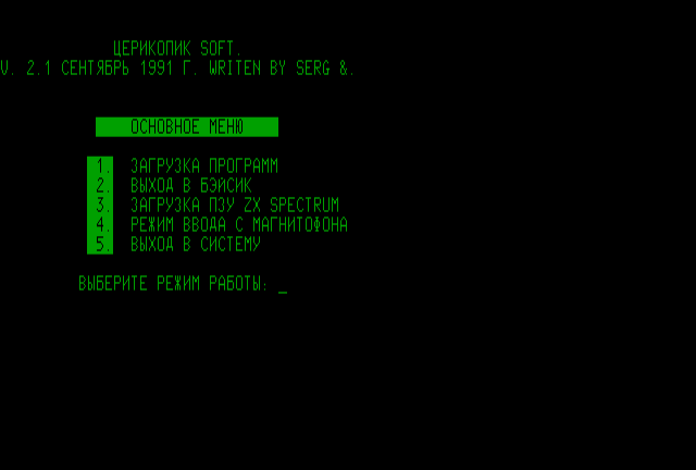

This is MENU of program SYS.COM:
Menu 2 & 4 runs file SYS1.OVLКод:wyberite revim raboty
1. operacionnaq sistema CP/M
2. operacionnaq sistema TR-DOS s bejsikom
p|wm "bajt"
3. operacionnaq sistema TR-DOS s bejsikom
p|wm "ZX SPECTRUM"
4. bejsik p|wm "bajt"
5. bejsik p|wm "ZX SPECTRUM"
Menu 3 & 5 runs file SYS2.OVL
