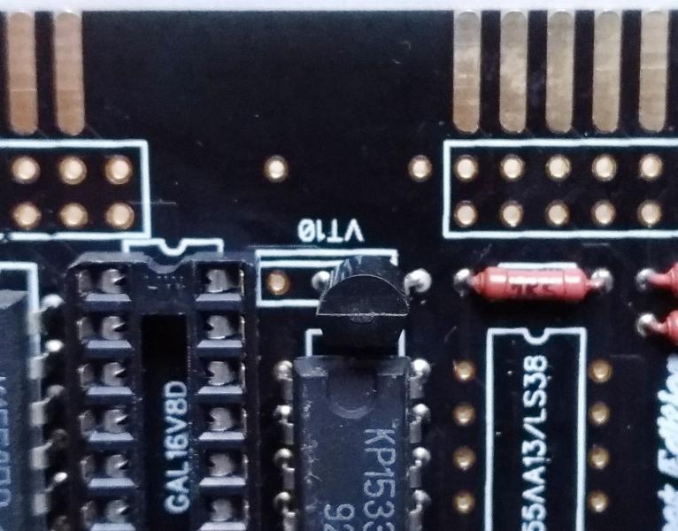

    I'm unsure about a few parts that need to be placed
    VT10 = KT361G? (schematics mention a KT209, but the footprint is wrong)
    VT9 = ???
    Also, the diodes seem to have changed largely ... I assume no value means KS522, while there are some KS156 and KS168
    02.07.2016
    г. Сороки, Молдова
    346
    129
    101 сообщений
    How to fit V10 KT209 (BC557) - look photo. V9 - KT361. Diodes KD522 (not KS). I think, KS168 instals only for protection purpose. You should use for assembling a diagram from that page https://zx-pk.ru/threads/30735-ispra...k-edition.html

    This is incorrect, it should be a BC557 (PNP just like KT209)

    Are any fixes needed with D59?
    Pin20 which should be VCC is connected to nothing as it seems.

    Yes, same fault on my PCB. There are many mistakes. Give me, please, more time, I'll try to find out, if someone has got working PCB.
