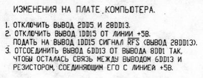

    In case anyone of you wants to build the Turbo extension on breadboard, I've made a soldering plan for myself, which I thought I could share with everyone.
    Leftmost ICs are TM2/74 while the right one is ЛА3/00, other values are according to the scheme (1n4148, 1k Ohm, 100pF). The board itself is designed to be as compact as possible with the wires going over the top layer being as short as possible
    Could anyone of you also be so nice and translate what the other text says?
    EDIT: appears the soldering plan I uploaded was resized ... here's a bigger version: http://img854.imageshack_.us/img854/3409/penturbo.png

    Shockwav3 попросил перевести текст со схемы Турбо доработки Пентагона 128.
    Modifications on the computer's PCB.
    1. Disconnect DD5-2 and DD13-28 from their circuits.
    2. Disconnect DD15-1 from the +5V circuit. Connect DD15-1 with the ~RFS circuit (DD13-28).
    3. Disconnect DD13-6 from DD1-8, but keep the connection of DD13-6 with the pull-up resistor.
