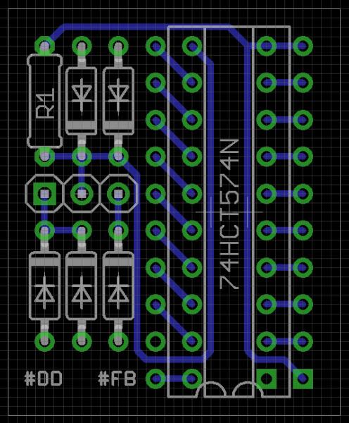

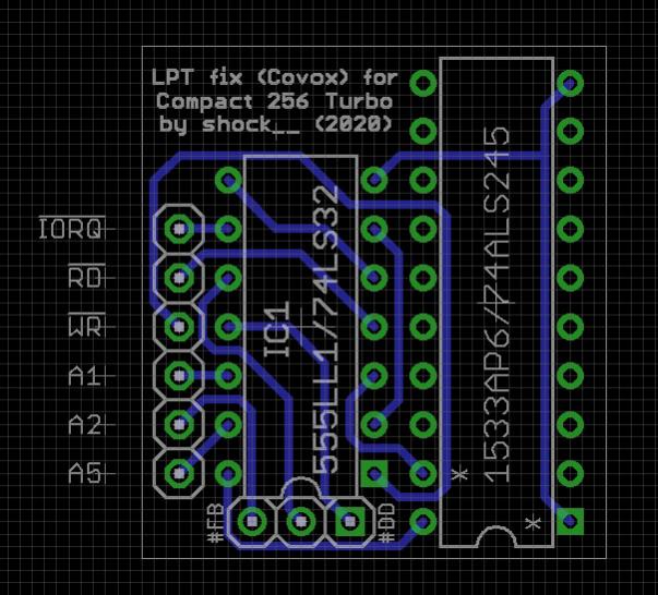

    Цитата Сообщение от Romych Посмотреть сообщение
    Printer port at 555АП6, unusable for Covox. It always translate data from D0-D7 to output pins. Printer catch data at Strobe signal, Covox does not... Covox on AY port (P0-P7) on "System bus connector" will work.
    Just got around to trying that ... doesn't work
    Neither with #DD nor with #FB (used this demo for testing: https://zxaaa.net/view_demo.php?id=3019)
    EDIT: If I understood things right, LPT is at #E7 on the Compact 256 Turbo
    This small daughterboard should adapt D0-D7 to either #DD or #FB (can be configured by jumper) ... keep in mind pins 1 and 19 from AP6 need to be isolated from the mainboard and the 3 470 ohm resistors should be removed. LPT control lines (Error, ACK, Busy) will no longer be supported and Strobe will probably be some nonsense that doesn't match up with the rest.
    I'll try to validate the circuit in the next few days and then upload the gerbers if all works out.
    EDIT2: Above won't work ... seems like it needs a 374/IR23. Basically going with this approach will work for Port #FB (with interference due to the higher adress bits not being excluded - i guess)
    https://www.zxaaa.net/screen4/lptgirl.png
    EDIT3: Alternative approach (being tested soon) - replacing the LS245 with a HCT574 and DRL
    EDIT4: confirmed working, alternatively one can use a 74LS32/555ЛЛ1 instead of the diode-resistor-gate which will reduce noise.

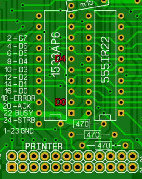

    Somehow the output on the Compact sounds extremely distorted (with above fix). Any ideas?
    Demo used: https://zxaaa.net/view_demo.php?id=5836
    Covox on Scorpion 256 Turbo+ (how it should sound)
    covox_scorpion256_turboplus.rar
    Covox on Compact 256 Turbo
    covox_compact256.rar
    EDIT: Problem found ... seems like D0 and D4 are absent from the inputs on AP6/245 ... if you reattach them sound on the covox is as expected.
