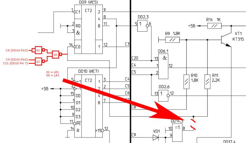

    Цитата Сообщение от Shockwav3 Посмотреть сообщение
    This is how I modified the board:
    after these changes, did the synchronization return to normal?

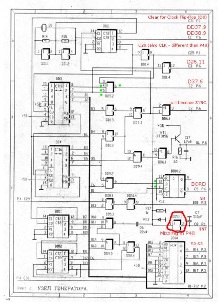

    Yes, everything back to normal after I removed the additional AND-Gates and put everything back into place.

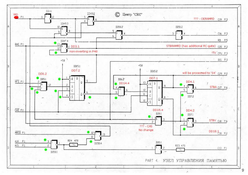

    Just for the sake of it, these are my attempts to "translate" the P128 schematics to P48 to make things a bit easier to compare.
    So far I've found nothing overly different

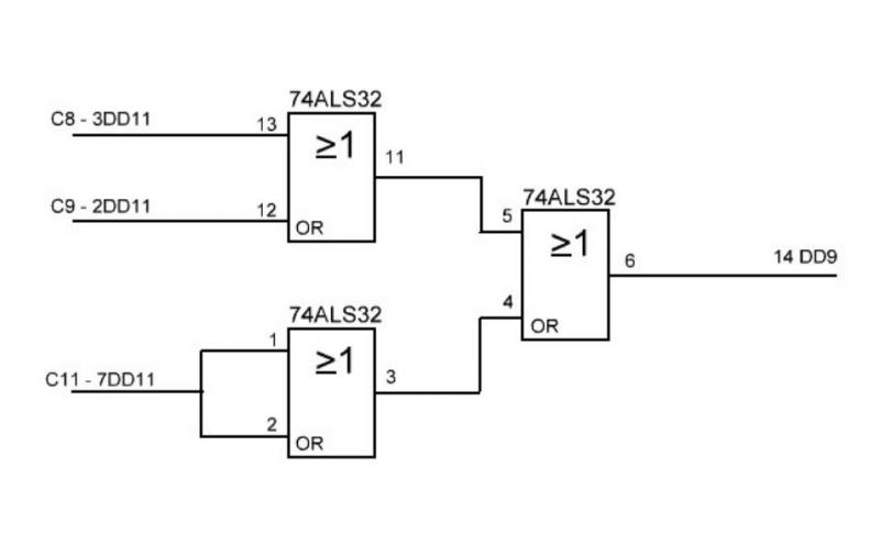

    Did you mean an additional 74ls32 (OR-Gates), or did you have something else additionally installed?

    Sorry, I meant OR-Gates of course.

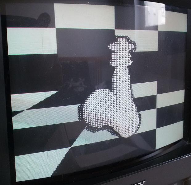

    Currently experimenting with the circuit proposed by LEN2PEN2.TXT (Output of DD6.3 [Pin8] through 1.2K resistor -> 6.8n capacitor tied to ground + inverter -> !INT on Z80) I'm getting something extremely close to a correct timing for the Rage endpart (can't see any offset while it's moving and the "paper wobble" at the beginning actually looked correct, with the screen standing it's 1px) - only problem, this only happens on every second or third reset.

    EDIT: Looks like I'm not quite done yet ... on a second testrun the border was 1 pixel late (instead of early), TestINT no longer reports a value and BorderCreate simply crashes.

    Looks like I finally got it right!
    I've now managed to move the paper a bit to the right and it lines up except for 1 pixel. This was done by recreating the clock0 for DD9 as done in the P128 (your approach in post #29 was almost right solegstar).
    BorderCreate, Rage Endpart, TestINT, Eyeache/Alienate are all working fine
    In case anyone wants to fix their Pentagon48 for 128 timing, here are the modifications I did:
    my congratulations!!! and it is strange that my circuit does not work. The logic of both schemes is the same. a logical zero will appear at the output only when all three inputs are zero. logical operation OR 74als32 fits perfectly on a single chip, instead of two NOR and NAND.
    Profi must live!

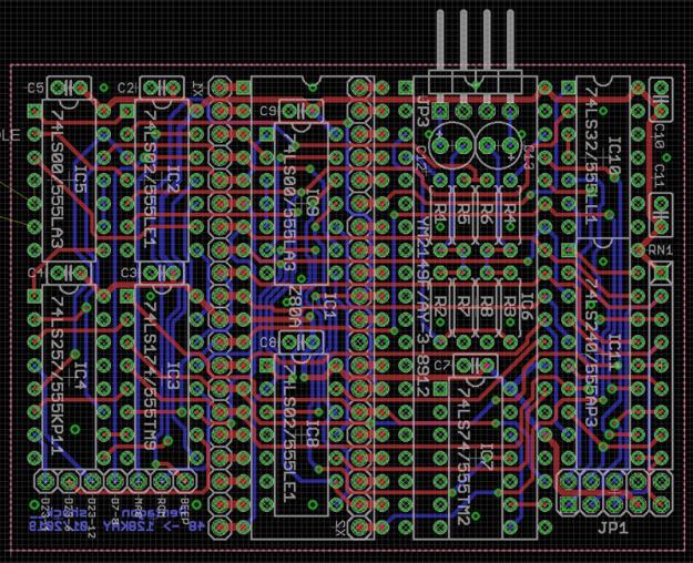

    Yeah, one pixel is fine for me for the moment I think inverting (part of) a signal or adding a delay/pullup/pulldown might fix it, but for the moment I'm done experimenting ... I'll get back to it in a few days once I finalize my INT + Mem + AY (+ Covox? [+ Kempston?]) interface.
    @solegstar: I'll get back to that as it's currently just a prototyping circuit. On my intended addon card (currently it's a bunch of loose wires and breadboard) I still have a few gates for spare (1x LS02, 2x LS32, 1x Flip-Flop from LS74)
