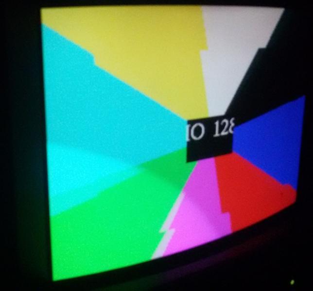

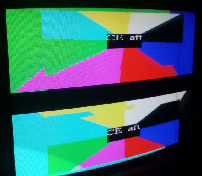

    Shockwav3, Can you temporarily disconnect the capacitor C2? Also show a photo of the screen.
    Perhaps, for faster testing you will be helped by the ROM-version of the last part demo RAGE.
    Profi must live!
    Моё железо...
    Все укомплектованы:
  9. #18
    09.09.2008
    Berlin, Germany
    252
    43
    47
    31 сообщений
    Thanks a lot for linking the ROM version - that makes things a lot more pleasant to work with for me!
    (Blurry) Screenshot as you asked (sadly my smartphone really sucks with moving screen images):
    I'll try unsoldering C2 next
    EDIT: C2 removed

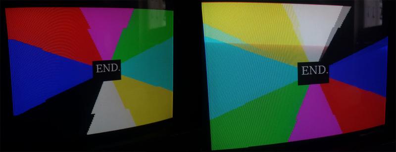

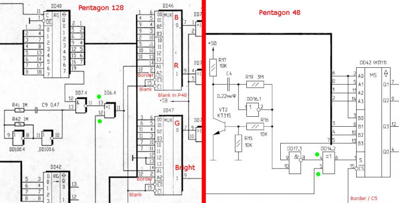

    Any chance this could be the reason? Seems like the P128 enables muxing based on BLANK, while the P48 enables muxing based on BORDER
    EDIT: Seems like generation of the BLANK signal is realized largely different and also utilized differently ... damn
    EDIT2: I think I've found the culprit! !WRFE is generated slightly differently, inverting it also gives me a slight improvement (Border and Paper are just a few pixels off instead of a full character). I'll try restoring it to the way the P128 does it and report again.
    EDIT3: Restoring the way !WR_FE is generated on the P128 improved things considerably, even tho I think simply inverting the signal generated on board gave me the same result.
    Left is before, right is after
