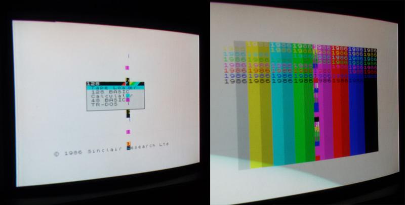

    Any ideas what might cause this? I've temporarly built in a 128K expansion, the ROM part seems to work fine.
    Somehow either with or without the expansion the 17th column of the screen always gets junk characters ... I've already tried swapping a few 74LS with 74ALS, albeit to no improvement. As vitsserg mentioned the FLASH attribute doesn't work here either. Just in case I already have ordered MC14520 chips.

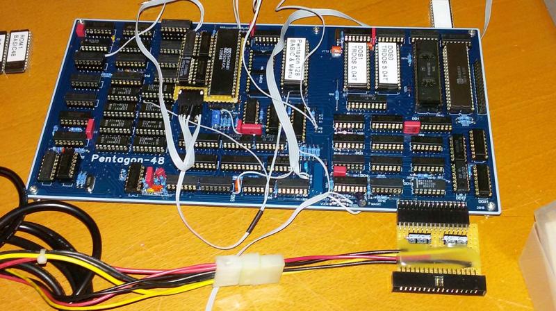

    Here's how my configuration currently looks like (no keyboard, no floppy as of now):

    Pentagon 48 + MIKAY128 + VG93 Turbo + Stereo Covox + KJoy

    Возможно, неисправна одна из микросхем памяти RAM.
    Какие микросхемы вы меняли с 74LS на 74ALS? У меня стоят все микросхемы серии 74LS, с ними компьютер работает хорошо.
    Для чего Вам нужна 14520? Это аналог 561ИЕ10. Здесь она участвует в формировании кадровых импульсов (D12). Именно 14520 у меня сейчас установлена.
    А сигнал FLASH формирует мультивибратор на DD16.1 - VT2. Попробуйте вместо КТ315 (VT2) поставить n-p-n транзистор с бОльшим усилением (beta).

    Seems to be related to decoupling and the power supply. Using another PSU, the machine runs fine - maybe it is because I haven't decoupled the Betadisk section yet (I ran out of capacitors ... but I have already ordered new ones as well)?
    But hey ... looks like the RAM expansion is working
    I did test a few sets of DRAMs (4164, 41256 [with A8 tied to GND], 41256 with 128k adapter) which were all known good before hand, which failed in the Pentagon.

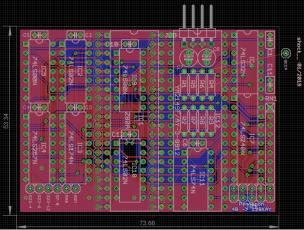

    Layout for the 128KAY expansion is getting there:

    Okay, some updates, after adding another wire for VCC, the machine works a lot more stable. I very, very rarely get screen errors and the diagnostics ROM often manages to do a few iterations of the RAM test before finding an error.
    Betadisk now works, after adding R19 (Pullup for 3DD13). Sadly after upgrading the machine to 128K it only works from the menu - RESDOS gives me a black screen for 2-3 seconds before going back to the menu. I did modify 1D2 to permanently lock the machine in ROM1.
    Appears there's only FLASH not working and BRIGHT being inverted remaining as issues. I already have a 561LN2 on order. Where exactly is BRIGHT formed?

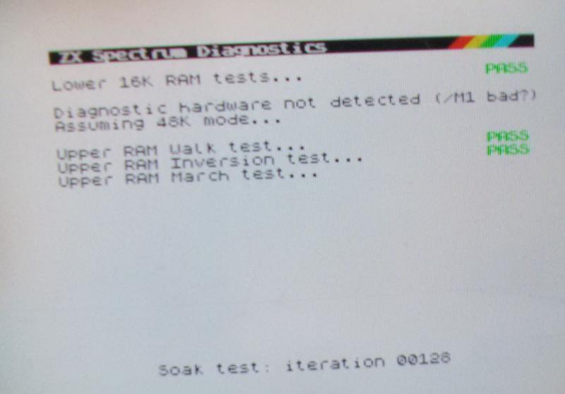

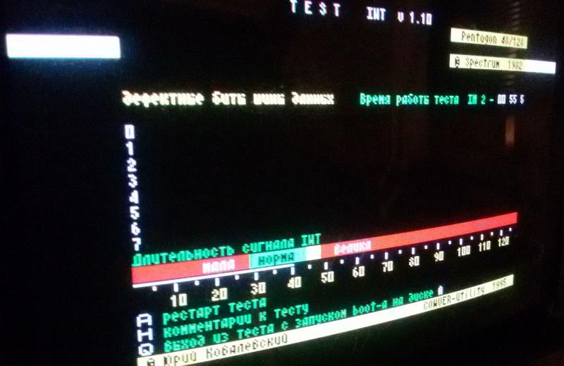

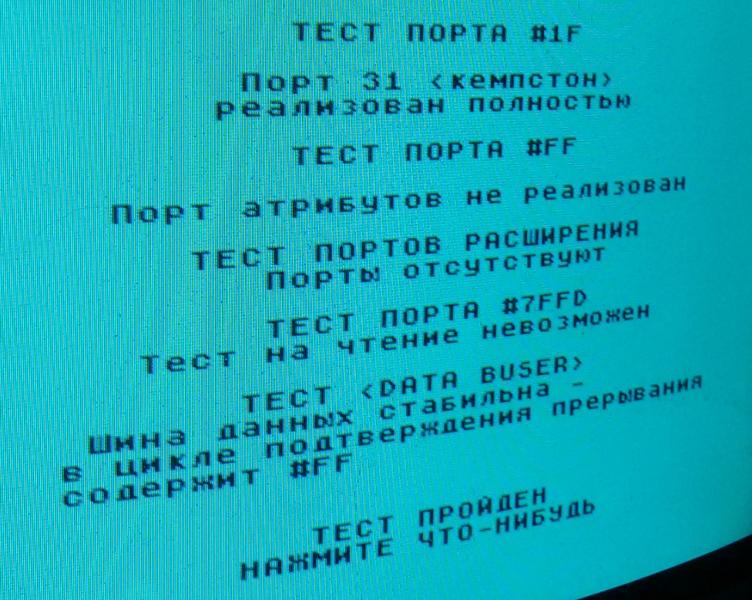

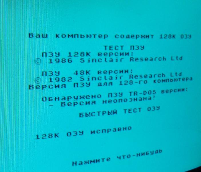

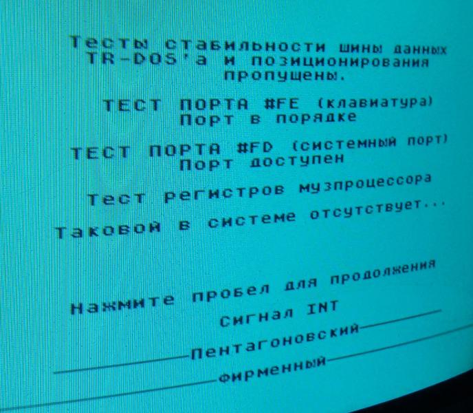

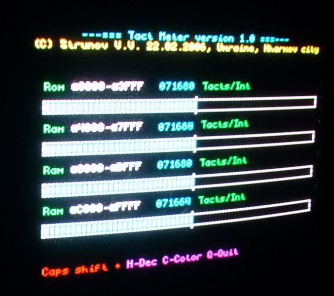

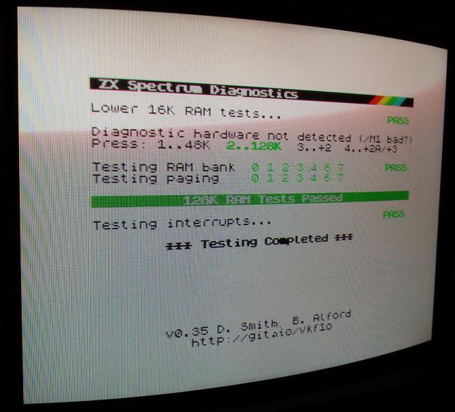

    Thanks solegstar ... seems like D16 is intervening there as well, which might be the source of my issues.
    I did run various tests on this machine by now, ZXDiag happily ran through it's RAM test for over an hour (48k mode), Test 4.3 and Tact Meter seem to report correct values. Yet TestINT 1.10 detects the machine to have a "start of paper" typical to the Sinclair machines (second to last photo)? This happens with and without the 128K expansion. I guess this would also explain why the multicolor image of the Alienate Demo isn't shown correctly (albeit being stable). Any ideas (or is this even normal?) or am I to suspect D16 once again?

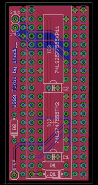

    On a sidenote: Would it make sense to add a joystick port to a 128K memory + AY expansion for the Pentagon48? Considering Port 1F is already realized via the 580BB55 @ DD25
    I've also started on a PCB layout for the VG93 Turbo mod (according to Spectrofon #14) once it has been tested I'll upload the gerber files.

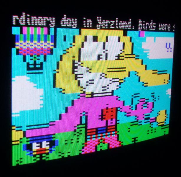

    EDIT: After changing DD22 from a 7405 to a 74LS05 things seem to work a lot more reliable now (previously I'd often get random errors), changing the PSU also seems to have helped (I'm usually using a 5V@2A + 12V@2A PSU that originally came with a portable hard disk drive).
    I've built a prototype of the VG93 Turbo on breadboard, yet I can barely notice any improvement? I'm using TRDOS 5.04T - formating a disk takes roughly 100 seconds. The demos I used for measuring the load speed also checked out at very similar times (Alienate [TRDOS Version by Triebkraft] 12 seconds from "run" til the selection screen).
    EDIT2: I've substituted D16 (K561LN2) with a 74HC04 for now. The good news is, FLASH is now working. The bad news is attributes are still inverted and the "start of paper" is still off.
    EDIT3: Got the attributes fixed, the 7406 on the underside for adjusting the video levels should be non-inverting (replace with 7407).

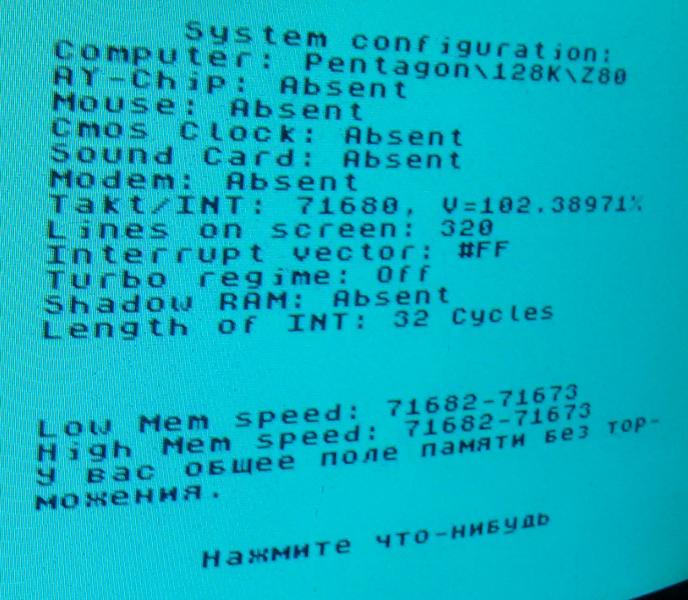

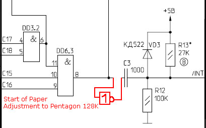

    If anyone of you could run this program on their 48k machines and tell me what the results are (the start of paper is the most interesting to me) that would be largely appreciated, since otherwise I've got my Pentagon 48 finished now
    TESI1_10.zip
    EDIT: Appears this is normal but can be "fixed" if any human could translate this post for me: https://zx-pk.ru/threads/28737-penta...l=1#post948251 that would be really amazing (google translate outputs kind of junk)
    EDIT2: Vertical adjustment works for me this way, this fixes Multicolor effects in Alienate, Eye-Ache and TestINT 1.10, Rage still has slight issues with the final part (horizontal adjustment) but is already a lot better.
    Proposal for fixing:

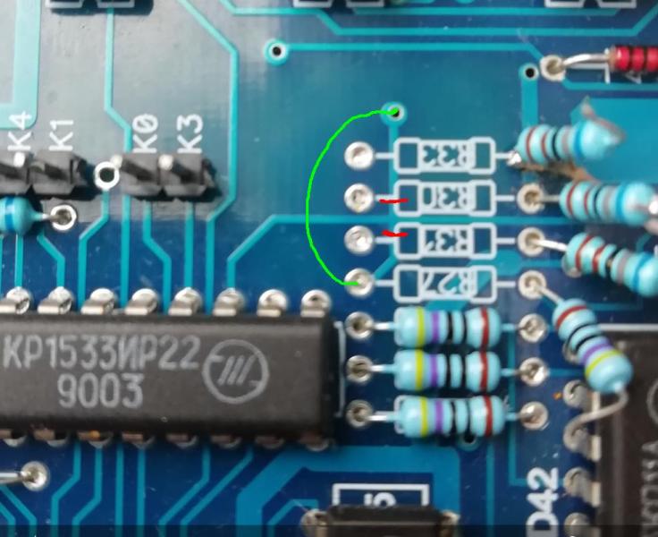

    Я свой собрал. Остались небольшие проблемки, с прогревом идёт срыв кадровой временами, и так ещё по мелочи. Зависит от марки C2, правда у меня номинал не совсем по схеме - стоит 330. Сейчас попробую поставить 2x150 может успокоится.
    Не работал магнитофонный вход. Проблема в плате, соединение 8DD16->13DD40 село на общий в месте где была доработка R27.
